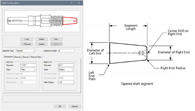

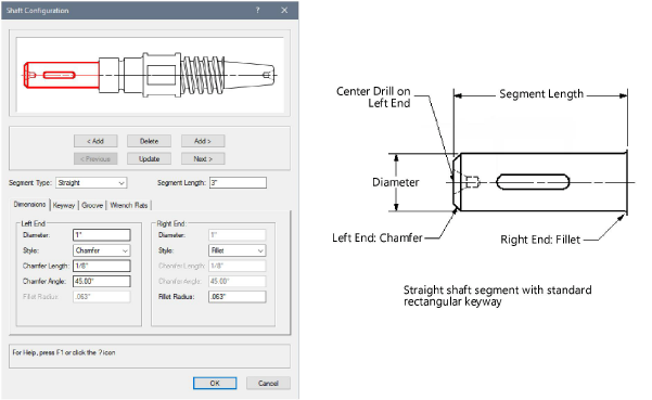

Segment Type
Select a straight, tapered, or threaded shaft segment type
Segment Length
Specify the shaft segment length
Diameter
For straight or tapered segments, enter the diameter of the ends
Style
For straight or tapered segments, select the end style
Chamfer Length
For straight or tapered segments, specify the length for chamfer/flare ends styles
Chamfer Angle
For straight or tapered segments, specify the angle value for chamfer/flare ends styles
Fillet Radius
For straight or tapered segments, specify the radius value for fillet/radius end styles

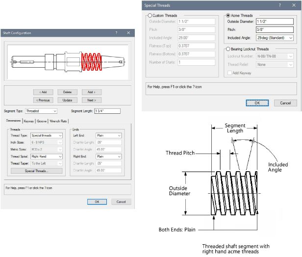

Thread Type
For threaded segments, select the standard inch or metric thread series, or select special threads to specify custom, Acme, or bearing locknut thread parameters; the selection in this field enables the associated thread size parameter or Special Threads button
Inch Sizes
For standard inch series, select the thread size and threads per inch
Metric Sizes
For standard metric series, select the thread size and pitch
Thread Spiral
For threaded segments, select whether to draw left hand or right hand threads
Thread Taper
For tapered pipe threads, select whether the taper points to the left or right
Special Threads
For threaded segments, click Special Threads to specify custom, acme, or bearing locknut thread parameters.
For custom threads, enter the outside diameter of threads, the thread pitch, the included angle of the threads, the flatness at both the top (at the outside diameter) and bottom (at the root diameter) of the threads, and the number of starts.
For Acme threads, enter the outside diameter of threads, the thread pitch, and select the included angle of the threads.
For bearing locknut threads, select the bearing locknut number, the thread relief position (if any), and add a keyway, if desired.
Left End/Right End
For threaded segments, select plain or chamfered for the left and right ends
Chamfer Length
For threaded segments, specify the length for chamfer end styles
Chamfer Angle
For threaded segments, specify the angle value for chamfer end styles

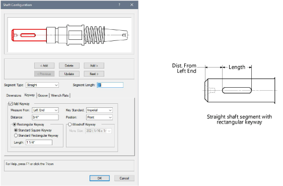

Click the Keyway tab to specify the configuration of the shaft segment keyway (straight Segment Type only).
Parameter
Description
Add Keyway
For straight segments, select Add Keyway to add a keyway to the current segment
Measure From
Select to measure the position of the keyway from the left or right end
Distance
Enter the distance from the end of the segment to the keyway
Key Standard
Select to insert either an imperial or metric keyway
Position
Select to position the keyway in the front, top, bottom, or back of the segment
Parallel Keyway/Rectangular Keyway
Select to add a rectangular or parallel keyway; specify either a standard square or rectangular keyway, and enter the keyway length
Woodruff Keyway
Adds a woodruff keyway; select the nominal size

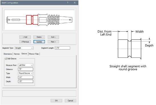

Click the Groove tab to specify the configuration of the shaft segment groove (straight Segment Type only).
Parameter
Description
Add Groove
For straight segments, select Add Groove to add a groove to the current segment
Measure From
Select to measure the position of the groove from the left or right end
Distance
Enter the distance from the end of the segment to the groove
Type
Select to add a round, rectangular, or V-groove
Width
Enter the groove width
Depth
Enter the groove depth

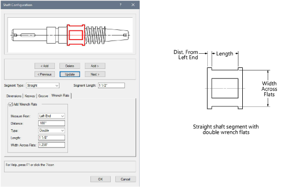

Click the Wrench Flats tab to specify the configuration of the shaft segment wrench flats (straight Segment Type only).
Parameter
Description
Add Wrench Flats
For straight segments, select Add Wrench Flats to add wrench flats to the current segment
Measure From
Select to measure the position of the wrench flats from the left or right end
Distance
Type
Select to add single or double wrench flats
Length
Enter the wrench flats length
Width Across Flats
Enter the width across flats of the wrench flats
