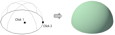

To create a hemisphere by radius:
Click the tool and mode.
Click to set the center of the hemisphere base.
Move the cursor to the desired radius and click to set the radius of the hemisphere base. The radius can also be set in the Data bar.

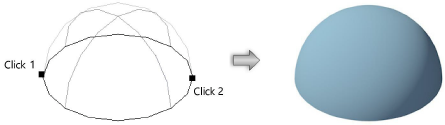

To create a hemisphere by diameter:
Click to set the first point on the hemisphere base diameter.
Move the cursor to the desired diameter and click to set the diameter of the hemisphere base.

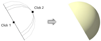

To create a hemisphere by up radius:
Move the cursor to the desired radius and click to set the rotation and top of the hemisphere.
