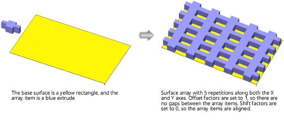

The Create Surface Array command duplicates 2D or 3D geometry onto a planar object or NURBS surface. This allows you to easily create free-form surfaces with geometric patterns, curtain walls, open framework, and more.
NURBS surfaces and certain 2D objects can serve as the base surface.
The following table describes the types of objects that can be used as array items, as well as the method used to project the objects onto the base surface.
Array item |
Projection method |
Solid |
Project by center of bounding cube |
Symbol instance |
Project by symbol origin |
2D/3D Locus |
Project by object definition points (the result is always a planar object) |
Extrude/multi-extrude |
Project profile object by definition points |
3D Poly |
Project by each vertex (the result may not be planar) |
Group |
Project member objects as described above; all members of the group must be legal array objects |

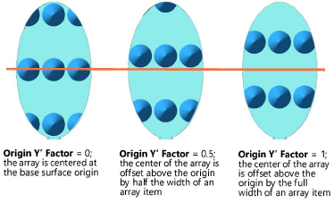

Origin Y’ Factor |
Enter the Y offset of the array pattern’s origin from the center of the base surface. The value must be a number between -1 and 1. For example, to shift each array item down by a quarter of the item’s length along the Y axis, enter -0.25. |

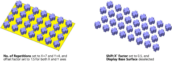

No. of Repetitions X’/Y’ |
If Repetition Mode is set to Number of Repetitions, enter the number of times the array object is to be repeated along the X or Y axis. The array objects are resized as necessary to fit the base surface. |
Fixed Distance X’/Y’ |
If Repetition Mode is set to Fixed Distance, enter the length of each array object along the X or Y axis. The number of array objects is adjusted as necessary to fit the base surface. |
Offset X’/Y’ Factor |
Enter a number to control the space between the array objects. The distance from the center of one array item to the center of the next item (in the same row or column) is the factor times the array item’s size. For example, if the array item is 12” total, and the Offset X’ Factor is 1.25, the distance from the center of one item to the next in the same row is 15” (12 x 1.25). If the offset factor is 1, the array items in that row or column touch each other; if the factor is negative, the array items overlap. |
Shift X’/Y’ Factor |
Enter a number to shift the position of the array objects from one row or column to the next. The distance from the center of one array item to the center of an array item in the next row or column is the factor times the array item’s size. For example, if the array item is 12” total, and the Shift Y’ Factor is 0.25, the distance from the center of one item to the center of the item to the right (in the next column) is 3” (12 x 0.25). If the shift factor is 0 (zero), the array items are aligned. |

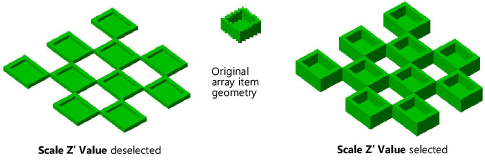

Scale Z’ Value |
When selected, the array objects are automatically scaled along the Z axis, proportional to how much the objects are scaled along the X and Y axes (to fit the base surface). When deselected, the array objects have the same Z value as the original array item. |
