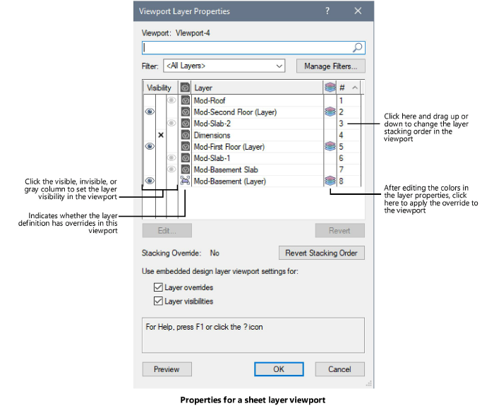

Select the viewport.
From the Object Info palette, click Layers.
The Viewport Layer Properties dialog box opens. Change layer visibilities and/or make layer attribute overrides for the selected viewport.
Parameter |
Description |

Layer list |
Lists the viewport layers and their visibility, edited status, layer color use status, and stacking order. Click the triangle in the heading of an active column to toggle between ascending and descending sort order based on that column parameter. |
Visibility |
Click on a layer visibility column to change the layer visibility for this viewport. Column 1: Visible (displays objects in this layer) Column 2: Invisible (hides objects in this layer) Column 3: Gray (displays objects in this layer as grayed) |
(Source)
Indicates whether the layer definition is the same as the source layer, or the layer definition has overrides in this viewport. When a layer is edited with the Edit button, the override icon displays automatically. Click the Revert button to revert to the original settings.
(Layer Colors)
Click to apply the viewport layer colors set in the Edit Viewport Design Layers dialog box (click Edit to set the colors, as described in the next step), overriding the design layer colors. This setting is independent of the Use layer colors document preference. |
# (Stacking Order) |
Displays the layer stacking order; drag a layer within the # column to change its stacking order. This column displays only when the viewport is in Top/Plan view. |

To override the layer properties (for viewport display), select one or more viewport layers and click Edit.
Alternatively, double-click a viewport layer to edit it.
The Edit Viewport Design Layers dialog box opens.
The same parameters apply when you create a design layer (see Setting design layer properties); for viewport layers, only the stacking order, transfer mode or opacity, and colors can be edited. These edits apply to the current viewport only, though they can be transferred to other viewports with the Eyedropper tool.
