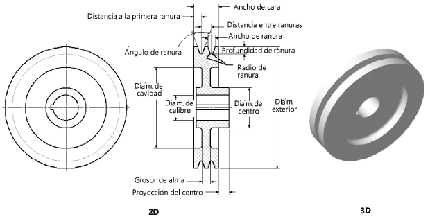

The pulley object accommodates both round belts and V-belts, and up to ten grooves.
To insert a pulley:
Click the tool and mode.
Parameter
Description
Outside Diameter
Enter the outside diameter
Groove Depth
Enter the groove depth
Groove Width
Enter the groove width
Groove Angle (deg.)
Enter the groove angle
Groove Radius
Enter the groove radius
Number of Grooves
Select the number of grooves (up to ten)
Dist. to First Groove
For multiple-groove pulleys, enter the distance from the left edge of the pulley to the center of the first groove
Distance Between Grooves
For multiple-groove pulleys, enter the distance between grooves
Face Width
For multiple-groove pulleys, this value is automatically calculated; for single-groove pulleys, enter the face width
Draw Recess
(2D only)
Select Draw Recess to draw a recessed web, and specify the 2D parameters
Web Thickness
Enter the web thickness
Recess Diameter
Enter the recess diameter
Recess Corner Radius
Specify the recess corner radius
Recess Fillet Radius
Specify the recess fillet radius
Draw Hub
(2D only)
Draws a hub
Hub Diameter
Enter the hub diameter
Hub Projection (Left/Right)
Specify the amount of projection for the hub on both the left and the right; a negative value indicates that the hub face is recessed
Hub Corner Radius
Enter the hub corner radius
Hub Fillet Radius
Enter the hub fillet radius
Draw Bore
(2D only)
Draws a bore
Bore Diameter
Enter the bore diameter
Keyway
If a keyway is present, select the Square or Rectangular recommended size, or select Custom size. The square and rectangular selections apply the ASME-recommended size based on the bore diameter.
Width/Height
For custom keyway sizes, enter the width and height values of the keyway

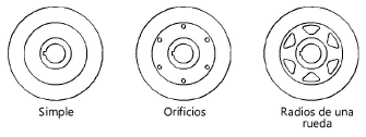

Web Configuration
(2D only)
Select the web configuration and then specify the 2D parameters, if any. When Holes are selected, their size can be specified as a percentage or diameter value.
Number
Indicate the number of holes or spokes for the sprocket (does not apply to Plain web configurations)
Size (10–100%)
For Holes (Percent) and Spokes web configurations, enter the percentage of the recess opening occupied by the holes or spokes
Center Distance
For Holes web configuration, specify the distance between the hole centers
Hole Diameter
(2D and 3D)
For Holes web configuration, indicate the size of the holes

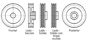

View
(2D only)
Select the 2D view
Show Center Lines
(2D only)
Draws the pulley with center lines
Show Root Diameter
(2D only)
Draws the pulley with a root diameter
