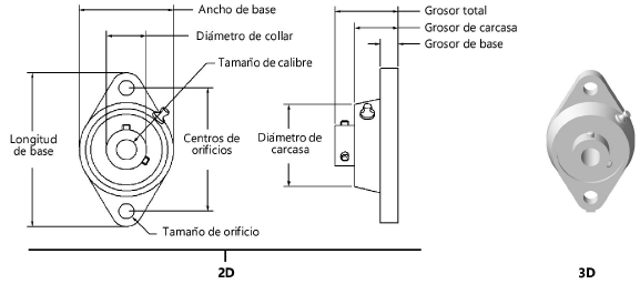

To insert a two-hole flanged bearing:
Click the tool and mode.
Parameter
Description
Nominal Size
Select one of the common flanged bearing sizes; the associated parameters are displayed in the Object Info palette
Use Custom Dimensions
Applies custom parameter modifications
Bore Size
Indicate the bore diameter
Collar Diameter
Specify the diameter of the bearing collar
Housing Diameter
Indicate the diameter of the housing
Base Width
Specify the width of the base
Base Length
Specify the length of the base
Hole Centers
Indicate the distance between the hole centers
Hole Size
Indicate the diameter of the mounting holes
Base Thickness
Specify the width of the bearing base
Housing Thickness
Enter the housing thickness
Overall Thickness
Specify the width of the bearing from the top of the collar to the bottom of the base
Set Screw Size
Indicate the size of the locking set screws

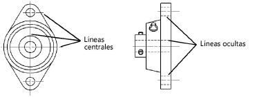

Show Center Lines and Hidden Lines
(2D only)
Draws the bearing with center lines and hidden lines
