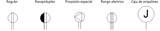

Set the size of the receptacle indicator; increase the scale value to obtain a larger object. Indicators maintain a constant size regardless of the drawing scale.
Config
Select the configuration of the receptacle, which is indicated by a preformatted shape
