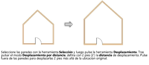

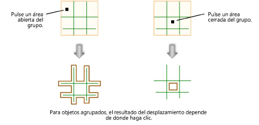

The Offset tool either creates a duplicate object offset from the original, or offsets the selected object from its original location. Use this tool to easily create parallel objects, such as lines and walls. Also use it to produce a larger or smaller version of closed objects, such as ovals and connected walls. NURBS surfaces are offset by the offset distance along the surface normal direction.

Offset by Distance
Places the offset object at the specified Distance from the original location

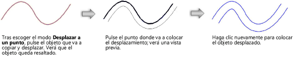

Offset by Point
Places the offset object at a distance specified by a mouse click

To offset one or more objects:
Select the object to be offset, if desired.
Click the tool.

Offset by Distance
Click on objects to offset
Select the object to be offset; the object is highlighted. Click to specify the offset location relative to the selected object, and to place the offset object. To continue offsetting objects, click another object to highlight it, and then click again to indicate the offset location.

Offset by Point
Select the object to be offset; the object is highlighted. Move the mouse to adjust the offset preview if necessary, and then click to place the offset object. To continue offsetting objects, click another object to highlight it, and then click again to indicate the offset location.
Offset selected objects
Click to set the offset point (move the mouse to adjust the offset preview if necessary), and then click again to place the offset object. The offset object is now selected; to offset from that object, click again to indicate the offset location.
