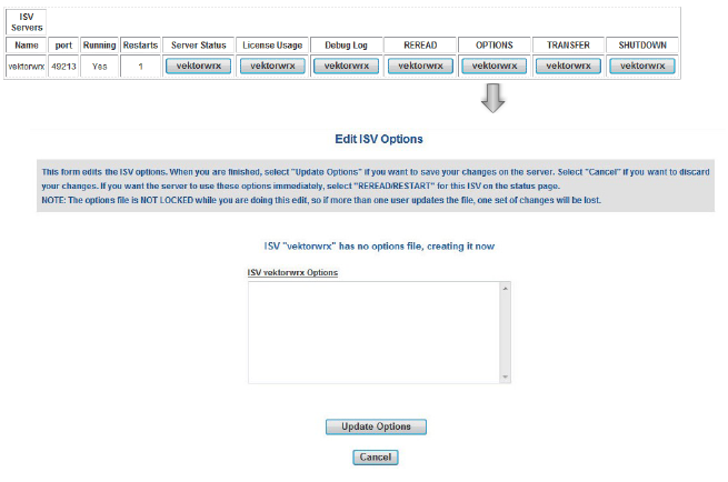

Alternatively, click Status from the main Server Administration screen. From there, click vektorwrx from the OPTIONS column.
The Edit ISV Options window opens.
Enter the following command into the ISV Options field.
Command |
Description |
Syntax |
REPORTLOG |
Sets up the location, file name, format, and type of Report log (small, std, or detailed). The file path can be specified as a relative or absolute path. If using a relative path, the current folder is the Vectorworks Site Protection Server installation folder. |
REPORTLOG “file_path_file_name” output_type Windows example: REPORTLOG “C:\My Reports\Reportlog.txt” detailed Mac example: REPORTLOG “My Reports/Reportlog.txt” std |
Add a + to the syntax to prevent the existing log file from being overwritten. |
REPORTLOG “+file_path_file_name” output_type |
Click Update Options.
A message states that “vektorwrx options file written.” Click Back to Status to return to the Status screen.
Click Reread/Restart Servers to restart the ISV server. The log file will be created in the specified location when the ISV server restarts.

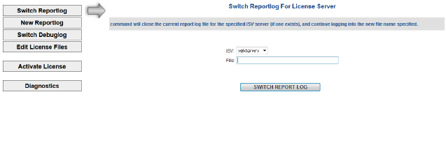

Switching to a different Report log file
You can switch from using the current Report log and specify a different log file. A Report log must already exist to be able to switch to a new one.
Click Switch Reportlog from the main Server Administration screen.
The Switch Reportlog For License Server screen opens.
Select vektorwrx from the ISV list.
In File, enter the file path where the log is located, including the filename.
Click SWITCH REPORT LOG.
The Report log switches to the other file.

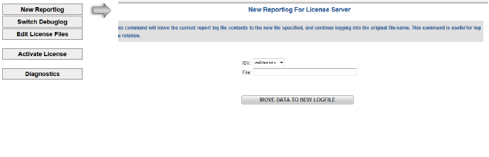

Creating a new Report log
You can save the current Report log file with a different name, and continue using the original file for logging. This is convenient for creating backup files.
The ROTATE command automatically creates backup log files. Depending on the operating circumstances, the log files can become very large; backing up regularly prevents the files from becoming too big. For more information, see Specifying server options.
Click New Reportlog from the main Server Administration screen.
The New Reportlog For License Server screen opens.
In File, enter the file path where the backup log should be located, including the filename.
Click MOVE DATA TO NEW LOGFILE.
The contents of the current Report log file are saved to the specified backup log. Logging continues in the current Report log file.
