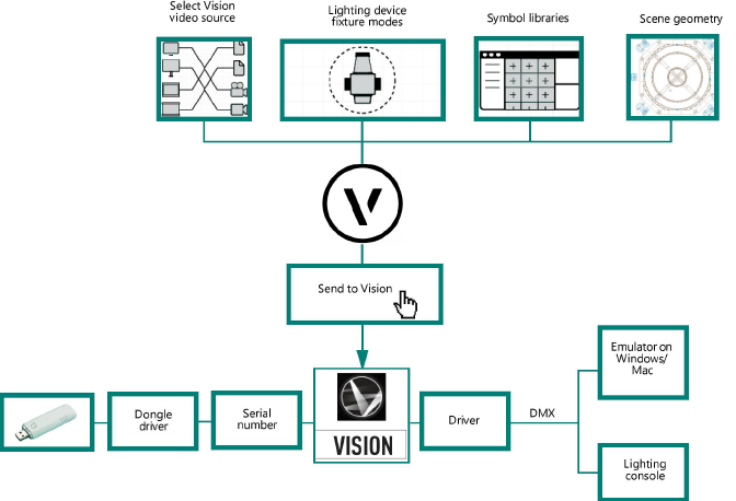

Using Vision with Vectorworks
Vision software is designed to work with Vectorworks Spotlight software. For information on Vectorworks, please visit vectorworks.net. For information on using the Vectorworks program, please refer to the Vectorworks online help system.
