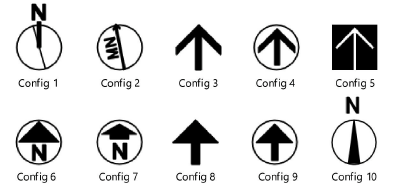

Config
Select the arrow style from the list
Arrow Graphics
Select an arrow style from the list; arrow styles include filled and unfilled versions
