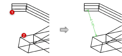

To constrain the distance between endpoints on separate objects:
Click the tool.
Click an endpoint to constrain.
Click a second endpoint to create the constraint.
A green distance constraint is drawn between the two points.
