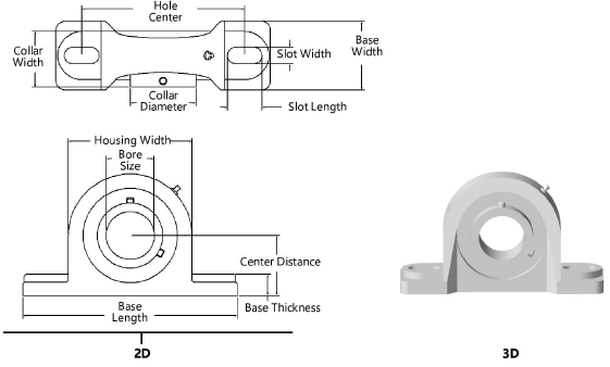

To insert a pillow block bearing:
Click the tool and mode.
Parameter
Description
Size
Select one of the common pillow block bearing sizes; the associated parameter values are displayed in the Object Info palette
Use Custom Dimensions
Applies custom parameter modifications
Bore Size
Indicate the bore diameter
Center Distance
Indicate the length from the center of the bore to the bottom of the base
Housing Width
Enter the width of the housing
Base Length
Specify the length of the base
Base Thickness
Specify the thickness of the base
Hole Centers
Specify the distance between the hole centers
Slot Width
Indicate the width of the slots
Slot Length
Indicate the length of the slots
Base Width
Specify the width of the block base
Collar Width
Enter the width of the collar
Collar Diameter
Enter the diameter of the collar
Set Screw Size
Indicate the size of the locking set screws
View
(2D only)
Select the 2D view
Show Set Screws
Displays the set screws
Show Grease Fitting
Displays the grease fitting
Show Center Lines and Hidden Lines
(2D only)
Draws the 2D bearing with center lines and hidden lines
