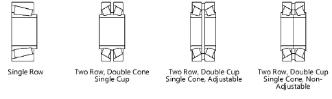

Bearing Type
Select from a variety of bearing types

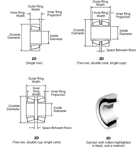

Inside Diameter
Specify the inside diameter of the bearing
Outside Diameter
Specify the outside diameter of the bearing
Width of Inner Ring
Enter the width of the inner ring
Width of Outer Ring
Enter the width of the outer ring
Space Between Rows
Enter the space between rows
Inner Ring Projection
Specify the projection distance of the inner ring

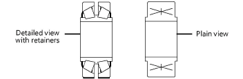

Show Retainers
Displays the bearing with retainers; Show Detail must also be selected in order to view the retainers in 2D bearings
Show Detail
(2D only)
Indicate whether to display a detailed 2D view of the bearing (including balls and/or retainers)
