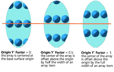

Origin X’ Factor
Enter the X offset of the array pattern’s origin from the center of the base surface. The value must be a number between -1 and 1. For example, to shift each array item to the right by half of the item’s length along the X axis, enter 0.5.
Origin Y’ Factor
Enter the Y offset of the array pattern’s origin from the center of the base surface. The value must be a number between -1 and 1. For example, to shift each array item down by a quarter of the item’s length along the Y axis, enter -0.25.

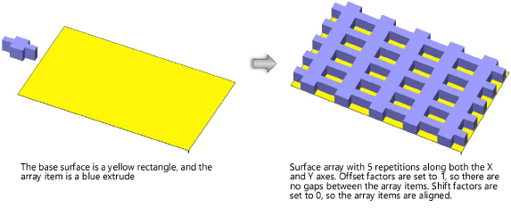

No. of Repetitions X’/Y’
If Repetition Mode is set to Number of Repetitions, enter the number of times the array object is to be repeated along the X or Y axis. The array objects are resized as necessary to fit the base surface.
Fixed Distance X’/Y’
If Repetition Mode is set to Fixed Distance, enter the length of each array object along the X or Y axis. The number of array objects is adjusted as necessary to fit the base surface.

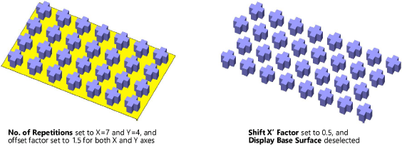

Offset X’/Y’ Factor
Enter a number to control the space between the array objects. The distance from the center of one array item to the center of the next item (in the same row or column) is the factor times the array item’s size. For example, if the array item is 12” total, and the Offset X’ Factor is 1.25, the distance from the center of one item to the next in the same row is 15” (12 x 1.25). If the offset factor is 1, the array items in that row or column touch each other; if the factor is negative, the array items overlap.
Shift X’/Y’ Factor
Enter a number to shift the position of the array objects from one row or column to the next. The distance from the center of one array item to the center of an array item in the next row or column is the factor times the array item’s size. For example, if the array item is 12” total, and the Shift Y’ Factor is 0.25, the distance from the center of one item to the center of the item to the right (in the next column) is 3” (12 x 0.25). If the shift factor is 0 (zero), the array items are aligned.

Display Base Surface
Select whether to display or hide the base surface

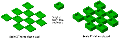

Scale Z’ Value
When selected, the array objects are automatically scaled along the Z axis, proportional to how much the objects are scaled along the X and Y axes (to fit the base surface). When deselected, the array objects have the same Z value as the original array item.
