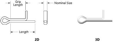

To insert a cotter pin:
Click the tool and mode.
Parameter |
Description |
Cotter Pin Type |
Select square cut or hammer lock
Nominal Size |
Select the nominal size in inches |
Grip Length |
Enter the grip length |
Length |
Enter the pin length |
Bend Angle (Top)/(Bottom) |
Enter a bend angle in degrees for the top and/or bottom section of the cotter pin |
View (2D only) |
Select the 2D view
