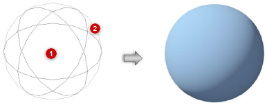

To create a sphere by radius:
Click the tool and mode.
Click to set the center of sphere base.
Move the cursor to the desired radius and click to set the radius of the sphere base. The radius can also be set in the Data bar.

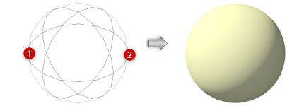

To create a sphere by diameter:
Click to set the first point on the sphere base diameter.
Move the cursor to the desired diameter and click to set the diameter of the sphere base.

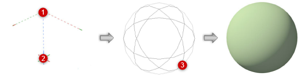

To create a sphere by center and radius:
Click to set the center of the sphere base on the working plane.
Move the cursor and click to set the height of the sphere above the working plane.
The center and height, relative to the working plane, of the sphere is automatically established if the first click is on a snap point—for example a 3D locus or vertex on another 3D object.
When in a non-isometric view, the sphere is created centered on the working plane.
