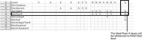

The Layermap worksheet contains a specialized set of identifiers which control how model design layers are configured for a project file. These identifiers, which are located on the extreme right of the Layermap worksheet opposite the model layers, are used by the Setup commands to correctly configure a set of model layers for the project file.
Model layer type identifiers can take on one of the following values:
Identifier
Meaning
C
Layer w/ ceiling referenced information (1 per floor)
F
Foundation layer (1 per project)
R
Roof layer (1 per project)
S
Slab layer (1 per floor)
W
Layer w/ floor referenced information (1 per floor)
<no value>
Supplemental model layer
