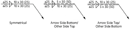

Symmetrical (both sides the same as Arrow Side)
(AWS only)
Reflects the same information on both the arrow side and the other side
Configuration
(ISO only)
Select the data display configuration; if symmetrical is selected, the data on the other side is identical to the arrow side
Arrow Side/Other Side
Select to display data on the arrow side, other side or both; if symmetrical is selected, the displayed data applies to both sides

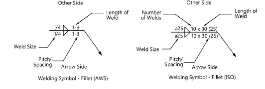

Weld Size
Displays the size of the weld
Number of Welds
(ISO only)
Displays the number of welds
Length of Weld
Displays the length of the weld
Pitch/Spacing
Displays the pitch or spacing of the weld
