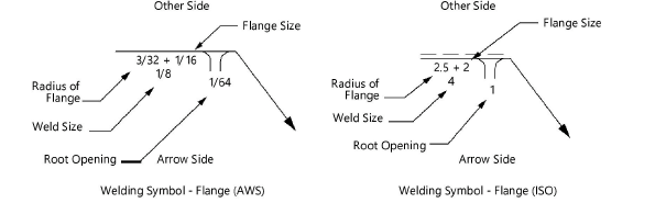

To insert a flange welding symbol:
Click the tool and mode.
Click to place the object in the drawing, and click again to set the rotation. The first time you use the tool in a file, a properties dialog box opens. Set the default parameters. The parameters can be edited later from the Object Info palette.
Once the object has been placed, its marker can be selected from the Attributes palette (see Marker attributes).

Type of Weld
Sets the weld type
Configuration
(ISO only)
Select the data display configuration
Significance
Select to display data on the arrow side or the other side
Weld Size
Displays the size of the weld
Flange Size
Displays the size of the flange
Radius of Flange
Displays the radius of the flange
Root Opening
Displays the size of the root opening
Complete Joint Penetration
Displays a complete joint penetration marker
Arrow
Sets whether to have an arrow on the leader line
Position
Select the side from which the arrow on the leader line extends (left or right)
Reference
Specify whether to include a reference note
Position
Select the position of the reference note; by default, Left is selected if the arrow is on the right, or Right is selected if the arrow is on the left
Ref. Line 1
If needed, enter the data to display in the first reference line
Ref. Line 2
If needed, enter the data to display in the second reference line
Ref. Line 3
If needed, enter the data to display in the third reference line
Field Weld
Places a field weld flag
Position
Sets the position of the field weld flag. Select Top |> to have the flag on top facing right, Top <| to have the flag on top facing left, Bottom |> to have the flag on bottom facing right, Bottom <| to have the flag on bottom facing left.
