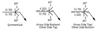

Symmetrical (both sides the same as Arrow Side) (AWS only) |
Reflects the same information on both the arrow side and the other side |
Configuration (ISO only) |
Select the data display configuration; if symmetrical is selected, the information on the other side is identical to the arrow side
Arrow Side/Other Side |
Select to display data on the arrow side, other side or both; if symmetrical is selected, the displayed data applies to both sides |

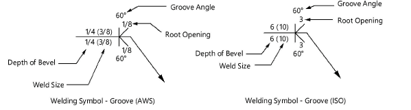

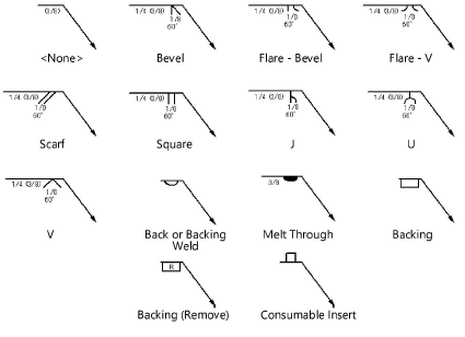

Weld Symbol |
Select the type of groove weld symbol to be displayed
Weld Size |
Displays the size of the weld |
Depth of Bevel |
Displays the depth of the bevel |
Root Opening |
Displays the root opening |
Groove Angle |
Displays the groove angle |

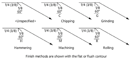

Finish Contour |
Select the finish contour type
Finish Method |
Select the finish method type
