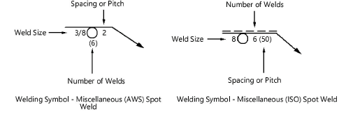

Weld Size
Displays the size of the weld. Applies to all weld types.
Length
Displays the length of the weld. Applies to the seam weld only.
Spacing or Pitch
Displays the desired spacing or pitch. Applies to spot, seam, and stud welds only.
Number of Welds
Displays the number of welds. Applies to spot, seam, and stud welds only.
