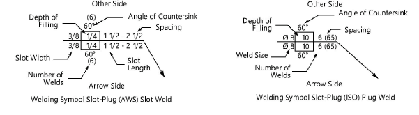

To insert a slot-plug welding symbol:
Click the tool and mode.
Click to place the object in the drawing, and click again to set the rotation. The first time you use the tool in a file, a properties dialog box opens. Set the default parameters. The parameters can be edited later from the Object Info palette.
Once the object has been placed, its marker can be selected from the Attributes palette (see Marker attributes).

Weld Size
(Plug Weld only)
Displays the weld size
Slot Width
(Slot Weld only)
Displays the width of the slot
Slot Length
(Slot Weld only)
Displays the length of the slot
Angle of Countersink
Displays the angle of the countersink
Depth of Filling
Displays the depth of the filling
Spacing
Displays the spacing
Number of Welds
Displays the number of welds
Finish Contour
Select the finish contour type
Finish Method
Select the finish method type
