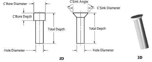

Hole Diameter
Enter the hole diameter
Total Depth
Enter the depth of the hole
Hole Type
Select one of the hole types
Drill Point Angle
For Blind Hole types, indicate the angle of the drill point at the bottom of the hole
Hole Style
Select the hole style
Diameter
For counterbored or countersunk hole styles, enter the diameter of the counterbore or countersink
Depth
For counterbored hole styles, specify the depth of the counterbore
Angle (deg.)
For countersunk hole styles, specify the angle of the countersink

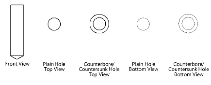

View
Select the 2D view
Show Center Line
Draws the 2D drilled hole with center line(s)
