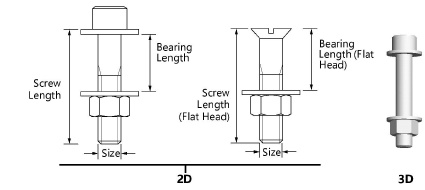

Bearing Length
Specify the bearing length or click and drag the bottom bearing length control point to define the bearing length graphically
Screw Length
For a custom length value, deselect Use Standard Length Increments and enter the length under the screw head; alternatively, click and drag the screw length control point to define the length graphically
