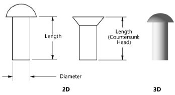

Diameter
Select a diameter in millimeters
Length
Enter the length under the rivet head (or overall length for the countersunk rivet)

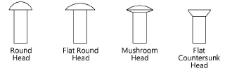

Head Type #1
Select a head type for one end of the rivet
Head Type #2
Select a head type, if any, for the other end of the rivet
