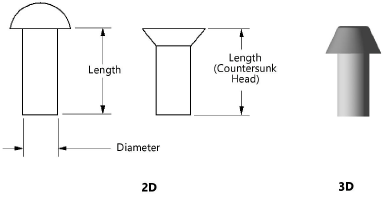

Diameter |
Select a diameter in inches |
Length |
Enter the length under the rivet head (or overall length for countersunk rivets) |

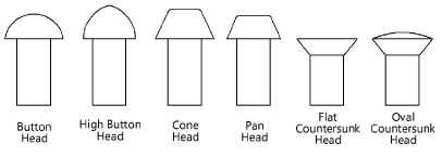

Head Type #1 |
Select a head type for one end of the rivet
Head Type #2 |
Select a head type, if any, for the other end of the rivet |
