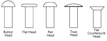

Head Type #1
Select a head type for one end of the rivet
Head Type #2
Select a head type, if any, for the other end of the rivet
