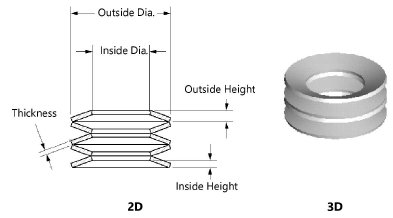

Inside Diameter
Specify the inside diameter of the Belleville spring
Outside Diameter
Specify the outside diameter of the Belleville spring
Thickness
Enter the wire thickness
Height
Enter the height of each spring section
Height is
Indicate whether the Height value applies to the Inside or Outside of the spring
