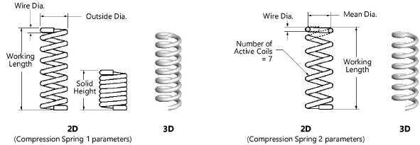

Type of Ends
Specify the spring end style
Outside Diameter
For Compression Spring 1, enter the outside diameter
Mean Diameter
For Compression Spring 2, enter the mean diameter
Wire Diameter
Enter the wire diameter
Solid Height
For Compression Spring 1, enter the solid height (compressed height)
Number of Active Coils
For Compression Spring 2, specify the number of active coils
Working Length
Either specify the spring working length value, or click and drag a spring control point to define the length graphically
Spiral
Select either a Left Hand or Right Hand spiral direction
