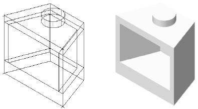

The Fireplace tool provides access to a variety of standard fireplace configurations available from the Resource Manager, in addition to individual objects created using the tool. The tool can be used to create your own fireplace styles (see Concept: Plug-in object styles).
