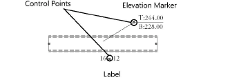

Duct work objects include optionally displayed labels and elevation marker tags. The label contents are determined by a user-defined string of values, such as width and height (obtained automatically) and any text desired. The elevation marker tag indicates the top and bottom distance above the finish floor of an HVAC duct work item; Show 3D Detail must be enabled to display the elevation marker tag. Both the HVAC label and elevation marker tag can be easily moved by dragging its control point to the correct location.
