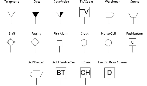

The Comm Device tool inserts an indicator and basic specifications to indicate the type and location of a communication device.

Select the configuration of the communications device, which is indicated by a preformatted shape
