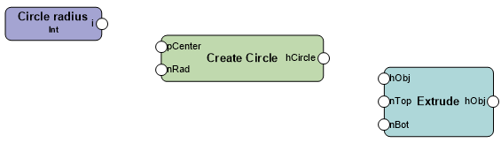

Looking at the placed node, you can see that it has two possible inputs: a center point and a radius value. We will add a radius value.
With the Marionette tool still selected, click Marionette Node. Enter "integer" in the search field, and double-click to select the Integer input node resource.
Click in the drawing to place the Integer node.
We will create a circle with a radius of 4. With the Integer node selected, enter a value of 4 for Integer in the Object Info palette. For Name, type "Circle radius." This helps you identify the purpose of this integer node. It is a good idea to name such nodes for easy identification, especially with complex scripts.
With the Marionette tool still selected, click Marionette Node. Enter "extrude" in the search field, and double-click to select the Extrude node resource.
Click in the drawing to place the Extrude node.

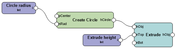

With the Selection tool , select the Integer node. A handle displays over the output; click it and click again over the radius (Rad) input of the Create Circle node to connect them. Connect the output from the Create Circle node to the profile (Obj) input of the Extrude node.
To run the Marionette script, right-click on any node in the network and select Run Marionette Script from the context menu. Alternatively, select Run from the Object Info palette.

To make the extrude taller, add another Integer node, and give it the value 10 in the Object Info palette; name it "Extrude height."
Connect the output of the new node to the Top input on the Extrude node.
Click Run from the Object Info palette.
