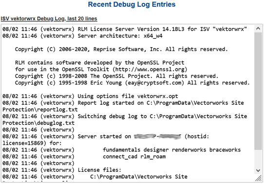

Displaying the debug log
Access: Select Usage > View Debug Log from the site protection System Menu.
Alternatively, click Status from the main Server Administration screen to access the Status screen. From there, click vektorwrx from the Debug Log column.
Description: Displays the last 20 lines of information related to the ISV server from the Vectorworks Site Protection Server command window. The information consists mainly of the records of the Vectorworks clients using or returning licenses.
Many of these functions are accessed more conveniently through the Site protection System Menu. The Debug log must be created before it can log data. See Switching to a different Debug log file.
Click Refresh to reload the Debug Log information. Click BACK to return to the previous screen.
