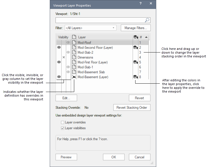

The Viewport Layer Properties dialog box opens. Change layer visibilities and/or make layer attribute overrides for the selected viewport or viewport style.
Properties for a sheet layer viewport

Layer list |
Lists the viewport layers and their visibility, edited status, layer color use status, and stacking order. Click the triangle in the heading of an active column to toggle between ascending and descending sort order based on that column parameter. |
Visibility |
Click on a layer visibility column to change the layer visibility for this viewport. Column 1: Visible (displays objects in this layer) Column 2: Invisible (hides objects in this layer) Column 3: Gray (displays objects in this layer as grayed) |

# (Stacking Order) |
Displays the layer stacking order; drag a layer within the # column to change its stacking order. This column displays only when the viewport is in Top/Plan view. |

To override the layer properties (for viewport display), select one or more viewport layers and click Edit.
Alternatively, double-click a viewport layer to edit it.
The Edit Viewport Design Layers dialog box opens.
The same parameters apply when you create a design layer (see Setting design layer properties); for viewport layers, only the stacking order, transfer mode or opacity, and colors can be edited. These edits apply to the current viewport or viewport style only, though they can be transferred to other viewports with the Eyedropper tool.
The viewport layer colors can be controlled separately from the design layer colors, for flexible presentation output. Click Colors to override the fill and pen colors for the selected viewport layer. To see the effects of the color override, Use Layer Colors must be selected in the Viewport Layer Properties dialog box for the selected viewport. This is similar to the way that Use Layer Colors must be selected in document preferences to see the layer color settings for a design layer, as described in Setting the design layer color.
Click OK to return to the Viewport Layer Properties dialog box.
Click Preview to evaluate the results of the property changes.
Click OK to return to the sheet layer or design layer.
