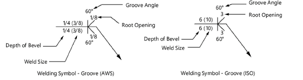

To insert a groove welding symbol:
Click the tool and mode.
Click to place the object in the drawing, and click again to set the rotation. The first time you use the tool in a file, a properties dialog box opens. Set the default parameters. The parameters can be edited later from the Object Info palette.
Once the object has been placed, its marker can be selected from the Attributes palette (see Marker attributes).

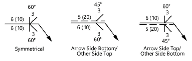

Symmetrical (both sides the same as Arrow Side)
(AWS only)
Reflects the same information on both the arrow side and the other side
Configuration
(ISO only)
Select the data display configuration; if symmetrical is selected, the information on the other side is identical to the arrow side
Arrow Side/Other Side
Select to display data on the arrow side, other side or both; if symmetrical is selected, the displayed data applies to both sides

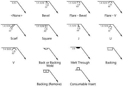

Weld Symbol
Select the type of groove weld symbol to be displayed
Weld Size
Displays the size of the weld
Depth of Bevel
Displays the depth of the bevel
Root Opening
Displays the root opening
Groove Angle
Displays the groove angle

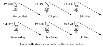

Finish Contour
Select the finish contour type
Finish Method
Select the finish method type
