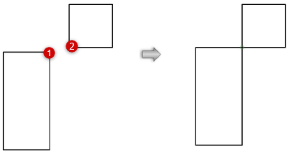

Constrain two selected points to remain attached. If one object is moved, the other constrained object moves to maintain the connection. If the points aren't connected when you place the constraint, the first object moves to connect to the second object.
To constrain the connection between two points:
Click the tool.
Click a point to constrain.
Click a second point to create the constraint.
A green coincident constraint is drawn where the two points touch.
