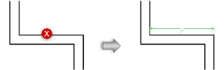

To constrain the horizontal distance between endpoints on a single object:
Click the tool.
Click the object to constrain.
A green horizontal distance constraint is drawn on the object.

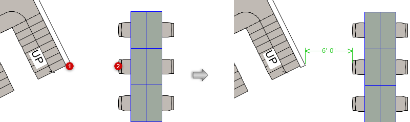

To constrain the horizontal distance between endpoints on separate objects:
Click the tool.
Click an endpoint to constrain.
Click a second endpoint to create the constraint.
A green horizontal distance constraint is drawn between the two points.
