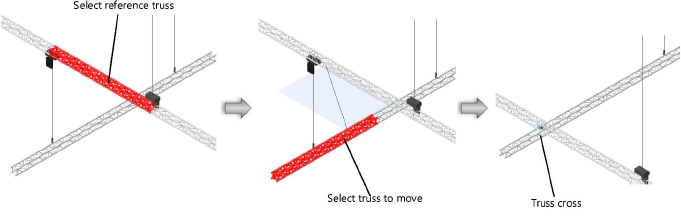

Connecting rigging objects with a truss cross
To connect rigging objects to each other with a truss cross:
Click the tool, and then, depending on whether you want to stack a truss above or below another one, click either Place Rigging Object on Top or Place Rigging Object Below mode.
If an offset is needed, enter the Offset value and toggle Enable Vertical Offset on.
To automatically number drops as they are placed, click Automatic Numbering, and then click Automatic Numbering Preferences; see Numbering objects at placement.
Click Preferences to open the Connection Options dialog box; select whether to use a symbol for the truss cross, and if so, from the Resource Selector, select a truss cross symbol. If you don't select a symbol, a rigid truss cross is inserted.
Click on the reference truss; this truss does not move.
Click on the truss to move (stacking the moved truss above or below the reference truss).
The truss is stacked with the reference truss, and any connected hoists, attached loads, and supports move with the truss. If hoists are connected between the trusses, they are removed; hoists connected to other truss sections may be lengthened or shortened.
A truss cross is created at the connection point. A truss cross indicates how to calculate and model the connection between stacked trusses. Depending on the selected symbol, its appearance indicates the type of connection (whether it is connected, flexible, or rigid; can transmit all forces, or only tension or only compression forces, or no forces). A label indicates the truss cross's name, type of connection, and the current force.
