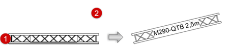

In Single Insertion mode, move the mouse to orient the truss, and click again to place it. For a hinge truss, click a third time to set the truss angle.

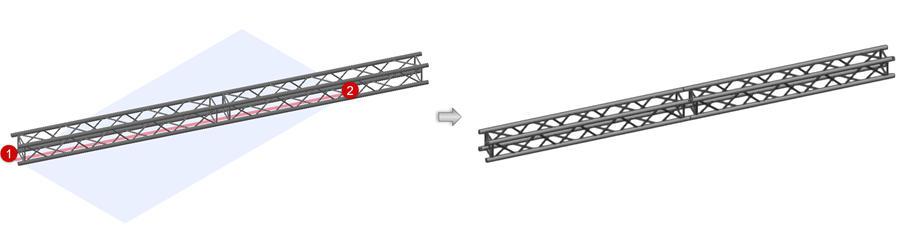

In Distributed Insertion mode, click to place the first truss. Move the mouse to orient and place the trusses along a line; trusses are placed end-to-end, and the preview indicates how many trusses will be placed. Click again to place trusses along the full length of the line. If the line length is not an exact multiple of the selected truss length, an additional truss is added to complete the line, resulting in a longer truss line.
Adding a truss in Single Insertion mode in Top/Plan view
Adding a truss in Distributed Insertion mode in a 3D view

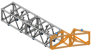

Hinge trusses are placed similarly and can only be placed in Single Insertion mode. After placement, select the hinge and adjust the hinge angle with the handles (or edit the Hinge Angle on the Object Info palette). The hinge angle must be between the Minimum and Maximum Angle specified in the Truss Properties dialog box; if not, the closest valid angle will be used.
Adjusting the hinge angle after placement (2D and 3D views)

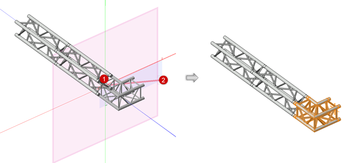

If you are placing a corner or hinge truss, click once to place the truss element at the highlighted location (where truss magnet snapping occurs). In a 3D view, the working plane appears, with a red guide line; move the mouse to view the possible orientations for the truss element, and click when you have the correct orientation. For a hinge, click one more time to specify the hinge angle. In Top/Plan view, you cannot see the working plane or the guide line.
