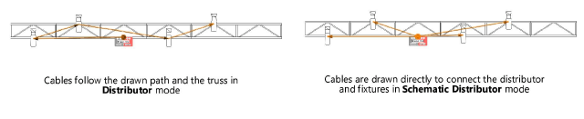

Distributor and Schematic Distributor modes both connect distributors to electrical devices. The first mode patches electrical devices to a distributor by creating cables that follow a drawn path. The second mode also connects distributors and electrical devices, but it draws the connection as a direct link, to clearly identify the devices plugged into the distributor. To automatically insert specific twofer symbols and parameter settings based on the cable connection type, specify the default twofer distributor to add in the Twofer Options pane of the Cable Preferences (see Setting cable preferences).

A cable connects each output from the distributor to the electrical device, either following the path drawn in Distributor mode, or with a direct path in Schematic Distributor mode. Depending on the Cable Preferences, the connector cables can appear curved for easy identification.
