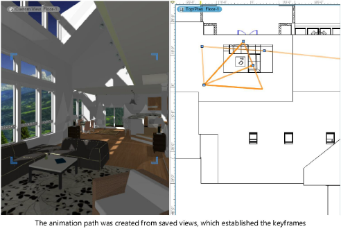

A walkthrough animation can be created by connecting a series of saved views. The camera moves sequentially among the specified views. This command creates a Fly Freely type animation path (see Types of animation path objects).

A Fly Freely type animation path is created on the active design layer. Keyframes are automatically placed at the corner and apex of every curve, and a triangular shape that indicates the camera view displays at the beginning of the path. See Editing animations to reshape the animation path, fine tune the camera's views, and adjust the speed along the path.
