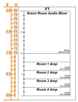

The rack ruler measures the height of equipment racks by placing a 2D ruler on the drawing or viewport annotation with both drawing unit and rack unit markings. The ruler measurements are displayed in the units specified in the document settings (see Units settings: Dimensions pane).

Height (RU) |
Sets the height of the rack ruler in rack units |
Base Offset |
If the rack ruler measurements should be offset from the base of the equipment rack, enter the offset value |
Click once to place the rack ruler; click a second time to set the rotation.
