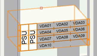

A rack frame is placed within a rack and it becomes associated with the rack, inheriting the rack’s ID/location and moving along with it; if dragged out of a rack, the rack frame becomes disassociated. Rack frames are used for modular equipment items. A rack frame can optionally be inserted stand-alone.
If the name of the rack frame matches that of an existing device, and Link device name is selected, the rack frame automatically uses the device’s make and model number. Once the device and the rack frame are associated, the rack frame parameters define the device's make and model, as well as its physical and location data.

Configuration
Slots H/V
Enter the number of slots in the frame, in the horizontal and vertical direction
Edit Slots
Opens the Edit Slots dialog box, for naming and numbering slots, and for setting the direction of multi-slot equipment as either horizontal or vertical.
As a shortcut, edit an existing rack frame symbol, and use the Spotlight Numbering command in object editing mode to quickly name and number the slots. (See Numbering Spotlight objects and Object editing mode.)
Options
Power Supplies
Select the number of power supplies in the frame
PSU Location
Select the location of the power supply units
PSU Size
Enter the size of each power supply unit as a percentage of the primary slot width
Front Door
Adds a door to the front of the rack frame
