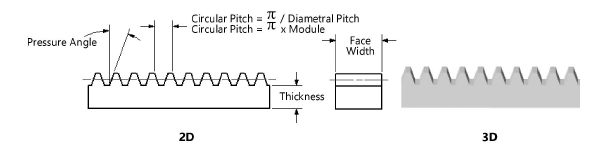

To insert a spur gear rack:
Click the tool and mode.
Parameter
Description
Method
Select whether to insert the spur gear rack using either a diametral pitch (for imperial sizes) or module (for metric sizes)
Diametral Pitch or Module (mm)
Specify either the diametral pitch or module, for the selected insertion method
Pressure Angle
Select the pressure angle
Number of Teeth
Enter the number of teeth
Thickness
Enter the base thickness
Face Width
Enter the width of the spur gear rack face
View
(2D only)
Select the 2D view
Show All Teeth
Draws the all teeth; deselect to draw only the end teeth
Draw Fillet
Draws filleted spur gear rack teeth
Show Pitch Line
(2D only)
Draws the spur gear rack with a pitch line
