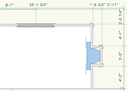

The exterior walls of a building can be automatically dimensioned with the Dimension Exterior Walls command. The command can:
Dimension relative to either walls or core components.
Dimension along either outer sides or centerlines of the walls or core components.
Associate the dimensions with the wall geometry.
Dimension only visible wall components.
Dimension windows and doors either to the center or the edges of the wall opening.
For window objects, the rough opening is calculated as the unit size plus two times the shim gap. For door objects, the rough opening is calculated as the leaf size plus two times the frame width plus two times the shim gap.

The exterior wall dimensions are drawn automatically.
