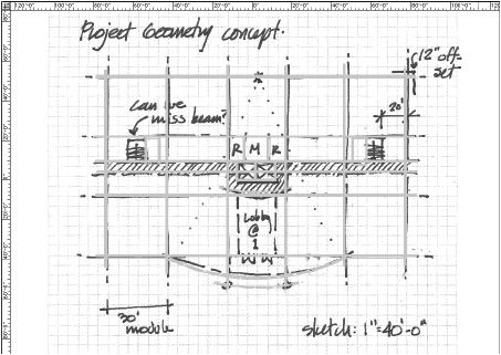

The following image shows a scanned sketch used as the basis for a guidelines layout. Draw guidelines in the Guides class. Prior to printing, turn this class off with the Modify > Guides > Hide Guides command. See Guides.
