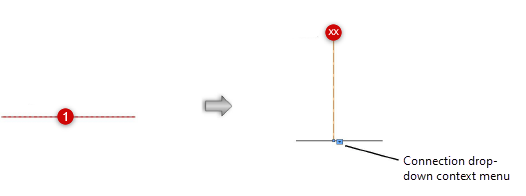

In Autoconnect mode, a pipe connects to existing outlets or other irrigation components as the pipe crosses over them while it is drawn. When Autoconnect mode is disabled, the end of the pipe needs to meet the other component to be connected. A pipe connected to another pipe splits the existing pipe in two. A pipe that is drawn over, but is not connected to, another pipe, displays with a "jump" arc to show that they do not intersect.

With this mode enabled, when the pipe is drawn over existing, valid irrigation objects such as valves, outlets, and POCs, they are automatically connected to the pipe. Connecting the drawn pipe to an existing pipe splits the existing pipe.
When this mode is disabled, the drawn pipe is not connected to objects unless the pipe’s endpoint touches the objects.

Click to place the start of the pipe, and draw the pipe polyline, clicking at each vertex. Double-click to finish drawing the pipe.
If Autoconnect mode is on, the pipe connects any valid irrigation objects that it crosses. When one end of the pipe is placed on another pipe, they are connected, and the existing pipe is split into two pipes.
Deleting the pipe later does not automatically reconnect the existing pipes.

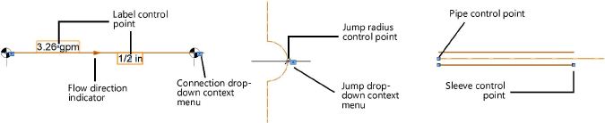

Pipe jump display
A pipe drawn over another pipe displays with a jump at the intersection of the two pipes. If drawing a lateral line over a main line, the lateral line displays with the jump.
The default jump radius is set in the Irrigation settings. From there, you can also set the radius of all jumps at one time, for a consistent look. Adjust the jump radius of an individual pipe with the control point; hide or show the jump with the Hide Jump or Show Jump drop-down context menu command.

The pipe properties can be edited from the Object Info palette.

Displays the length of the pipe, which can also be adjusted with the pipe control points on the drawing

Attach Tag/Label
Automatically attaches a Tag/Label object to the object. The last selected tag/label for the object type is applied; click the tag/label to edit its properties (see Adding labels to irrigation objects).
Show Nominal Diameter
Places a nominal pipe diameter label on the drawing
Show Flow
Places a flow rate label on the drawing
Show Flow Direction
Places a flow rate directional indicator on the drawing
