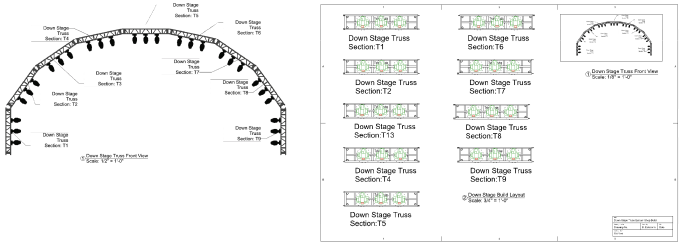

The Create Schematic View command uses the 3D model to create easy-to-read 2D views for paperwork. Specify the 2D view for each schematic view while preserving the 3D model’s orientation and view settings. For example, print schematic shop drawings in Top view while maintaining a Front view of the model for section viewports. See Creating schematic views for details.

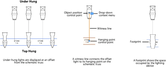

Schematic views can show equipment that is obstructed from view in the model. For example, under-hung devices can be offset from the truss in a schematic Top view. Witness lines connect the offset devices to their hanging points on the truss. Hanging points define where the associated loads are calculated in the 3D model (Braceworks required). Optionally, a footprint on the schematic rigging object indicates the space occupied by the load.
To control the attributes and visibility of witness lines and footprints, set their classes on the Spotlight preferences: Loads and Rigging pane.
